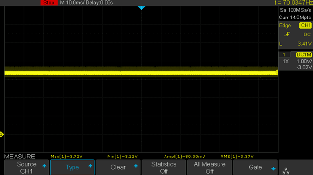

2025-05-30 3:13 AM
This is the 3v3 to gnd power supply that feeds the MCU
2025-05-30 3:15 AM
So just plugging-in the connector makes no difference - it's not until you actually connect RTT that your target "unblocks" ?
Have you asked Segger about this? They may have insight into what happens during/after an RTT connection which might cause this...
https://forum.segger.com/index.php/Board/3-J-Link-Flasher-related/?s=35d02df31511720cdf7a9f94838ca4a097a95584
@massimoperdigo wrote:opened the J-Link RTT Viewer, which doesn’t start a full debug session.
I'm not sure that it makes any difference as far as the core is concerned ?
As far as the Core is concerned, I think it's all just a DAP connection?
Again, Segger may be able to clarify that.
Does your code have anything which checks for a debugger connection; eg, to allow debug through sleep modes, prevent disabling debug pins, etc?
