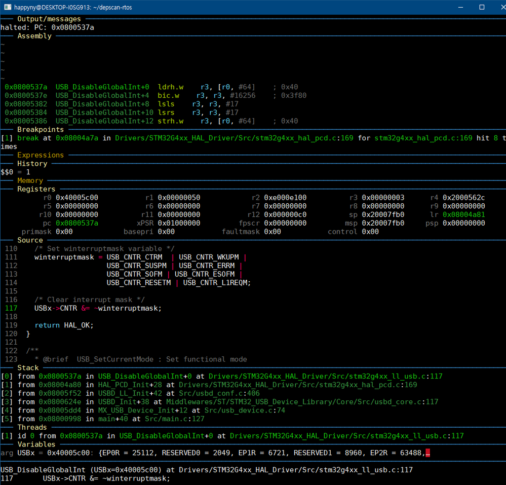

The point where the problem occurs is inside the USB_DisableGlobalInt function. In the process of masking the interrupt mask to USBx-> CNTR, all interrupts are immediately interrupted (including the SWD of ST-LINK) and the chip is reset after a certain time.

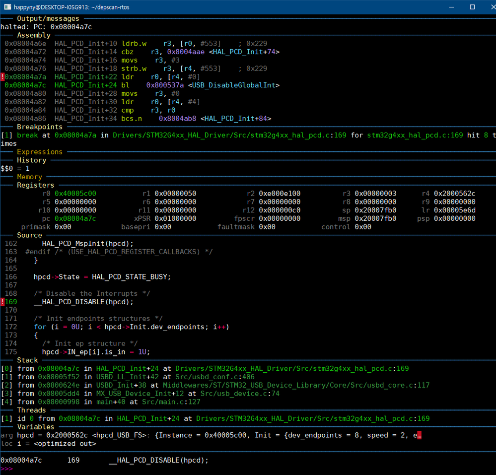

Single-step in disasm. Show line where the "freeze" occurs, together with context (previous lines, content of registers).
I'm using gdb-dashboard, you'll may recognize statement easily with images.
Program runs properly before branch into the function USB_DisableGlobalInt()
Right after jump into this function, it seems working properly.
Yet if I step one instruction on this statement, connection immediately shutdown and freezes.
Oops, sorry, Image was not uploaded ... Plz see next comment
(Click to see)
[2]
After above statement, the system does not respond anymore; freezes.
Since the program freezes as soon as the pc enters the function USB_DisableGlobalInt(), I have inserted several meaningless volatile instructions as a test in front-side of the function. However, it still freezes as soon as jumping into this function, even before executes them.
It seems like the function call itself freezes the program.
