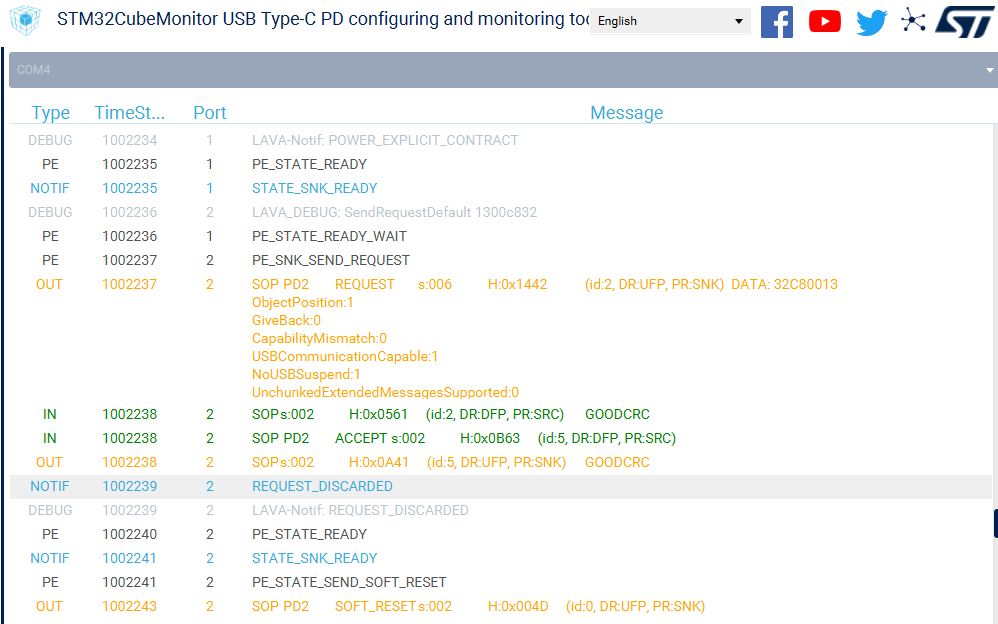

Sometimes, on the Sink port, I see the "REQUEST_DISCARDED" message (Type: NOTIF).
The timing I see the message is after "REQUEST" sent, "GOODCRC" received, "ACCEPT" received, and "GOODCRC" sent.
Message exchanges are normal, but PE reports "REQUEST_DISCARDED" even though message exchanges are successful.
And then, the Sink sends a "SOFT_RESET" message, and sends "HARD_RESET" eventually.
Since it is invisible to me where the "REQUEST_DISCARDED" message comes from (probably it happens in the STM32 static library), I have no idea what is happening inside.
Would it be a timing issue because 2 PEs are running at the same time or a control register have some peculiar values?
I would like to know cases that "REQUEST_DISCARDED" message is issued.
Please let me know if anyone has any idea.

Hello @nicolas P​ ,
I have Dual-Role (UCPD1) and Sink (UCPD2) port in my application.
I am sending Request data message in several cases, and encounter "REQUEST_DISCARDED" occasionally.
The below is what I see when that happens.
I added a snippet and screenshot of the debug messages.
(If you don't recognize functions or values in the snippet, they are created by myself.)
I have no idea how I can debug this error.

Looking at your code :
case USBPD_NOTIFY_STATE_SNK_READY:
    	if (GetRequestState() == REQUEST_MSG_READY)
    		/* Sink Port: Send a Request message to get a new contract */
    		if (GetRequestDO() != 0) {
    			SendRequest();
    		else
    			UpdateRequestState(REQUEST_MSG_SENT);
    			SendRequestDefault();
If I understand correctly, you want to send a request whenever a port is in SNK_READY.
In the trace we see that port 1 (the DRP one) is in sink_ready, but the request is sent on port 2 (the sink only port). Is it what you want to do ?
Don't you need to specify which port will send the request ?
For the moment I don't understand why there is a discard.
Hi @Nicolas P​ ,
Your understanding is correct.
SendRequest() and SendRequestDefault() send a Request message on the Sink port side. The port number is specified inside of the functions.
In which cases is the REQUEST_DISCARDED message generated?
Where do 'NOTIF' type messages come from?
If they are from PE layer, it is going to be very difficult for me to find the error since I believe the messages are generated by the USBPD core library.
(I am using USBPDCORE_PD3_FULL_CM0PLUS_wc32.a.)
