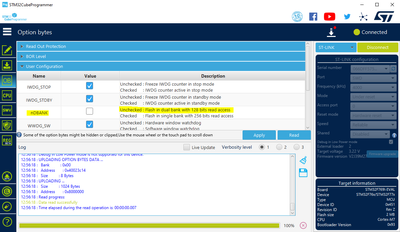

To switch from dual-bank to single-bank mode ,  we recommend using STM32CubeProgrammer to modify the flash option bytes by :
1- Connect your device to your PC and open STM32CubeProgrammer.
2- Navigate to the Option Bytes tab on the left sidebar (highlighted as "OB" in the image).
3- Under User Configuration, locate the option named nDBANK.
4- You will see that:
       When unchecked, the device operates in dual bank mode with 128-bit read access.
       When checked, the device operates in single bank mode with 256-bit read access.
5- To disable dual bank mode, check the nDBANK box to enable single bank mode.
6- Click Apply to program the option bytes.
