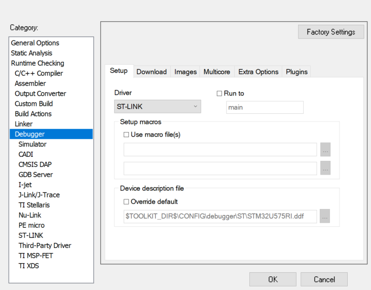

Mike_ST
I'm not sure this is related to a reset method.
If you uncheck the "Run To" "main" option in the debug options, maybe that can help you to see what is actually happening ?
Thank you @Mike_ST​ . If "run to main" unchecked, the debugger stops in the assembly startup at reset handler of the main app. No way to reset to the boorloader, unless the bootloader itself is the active project.

So, the suitable hook function in the debugger script is execUserExecutionStarted.
It is called when the debugger stops at main() (or reset handler) of the "active" image and is ready to continue.
In this function, I reset the MCU again, then it properly runs thru the bootloader, stops on main() and calls the execUserExecutionStarted hook again.
