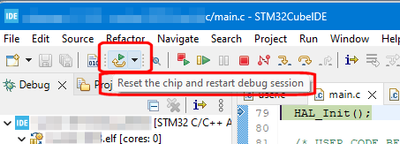

I'm want to send a string from one stm32 to another stm32 to blink an led on it I'm using uart polling method to do that.
The communication happens and led blinks only if I press the Reset button once I switch off and on power supply. What should be done if I want continuous communication.

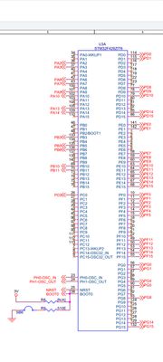

is this a custom board? BOOT0 pulled Low?
Try to provide some more detail rather than symptom.
Yes it's a custom board and. Boot0 is pulled low.
Still lacking detail - that shows us nothing other than BOOT0 is connected to ground.

Well, that code should transmit continuously in a loop.
Does it run under debug?
BTW: you've marked by previous reply as The Solution - but I don't think it solves your problem?
Yes the code runs under debug once the supply is made off and on the code works after i press the reset button on any of the two board.
BTW: you've marked by previous reply as The Solution - but I don't think it solves your problem?       I clicked it by mistake.
I mean if you run it within the debugger in the IDE - does the restart button within the debugger successfully restart the code?
Once you've clicked it, you have the option to undo that ...
harry123
Senior II
Yes it works
