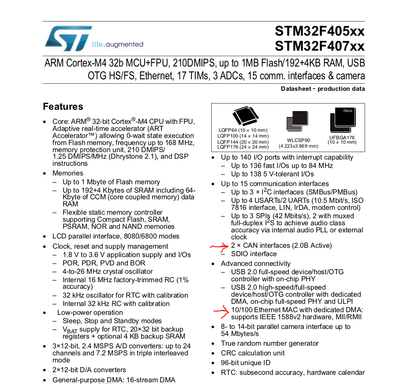

A F405/407 variant ?
> ... I tried to find more affordable option.
Affordability is usually a function of Flash size and pin count.
You could check what memory sizes and IO channels you need for your application, LQFP64 is the smallest casing variant.

1) STM32F407 will be a good option, but I thought that STM32H563 has lower price + better performance, that's why I wanted to know if I can add the FreeRTOS on it smoothly. I found that X-Cube-FREERTOS is available for STM32H563, but I also found some articles that people struggled to install it and some people believe that STM32H5 series can't be used with FreeRTOS.
If X-Cube-FREERTOS doesn't support full function as FreeRTOS, then I would consider STM32F407 instead.
