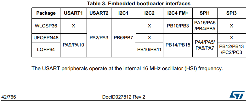

I found that STM32F410 reference manual is incomplete:
http://www.st.com/resource/en/reference_manual/dm00180366.pdf
There are no bootloader interfaces for UFBGA64 and LQFP48 packages in the table 3 on page 42:
Please, provide information about bootloader USART interfaces for UFBGA64.

Posted on March 26, 2018 at 17:19
The parts share a common die with common ROM firmware in multiple packages. Take the datasheet and draw across the packages with a high-lighter pen in the Pin Table. The 48-pin and 64-pin packages are going to be good proxies for each other. The PA9/PA10 and PA2/PA3 USART options will work on any of the packages with >=48 pins.

Hello
Yauhen.Sinkevich
Sorry for this delay to answer you.
In fact, the availability of a specific bootloader interface is only depending on the I/O availability.
The LQFP48 is as the UFQFPN48, a
nd the UFBGA64 is as the LQFP
I have already raised this missing information internally to the appropriate team to add the information in the next release.
