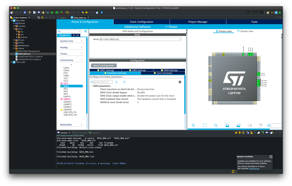

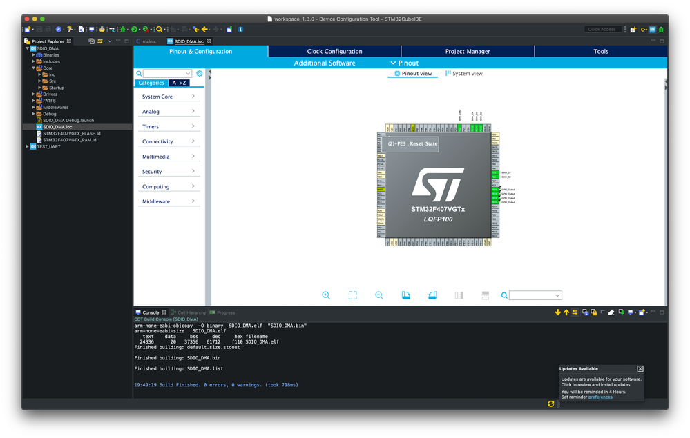

Cube MX set-up :
1 - pin

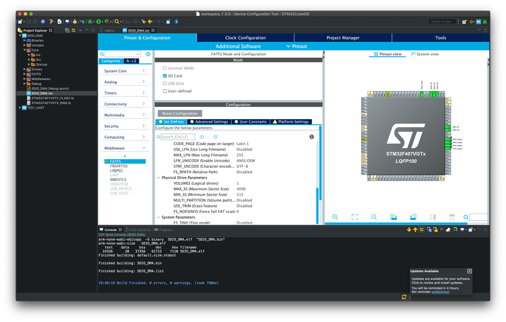

2 - FATFS configuration :
Only Physical drive were changed.
3 - SDIO set-up :
Please ask if you need more insight.
