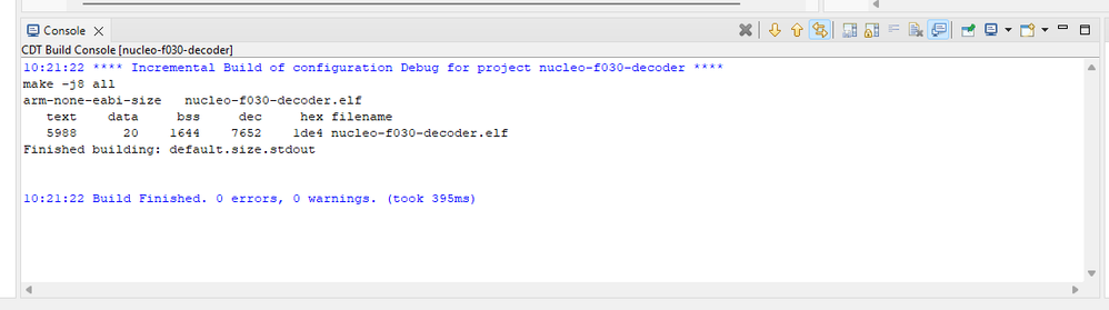

The console window does not open and hence am not able to see the errors.
Not even when you do a build?

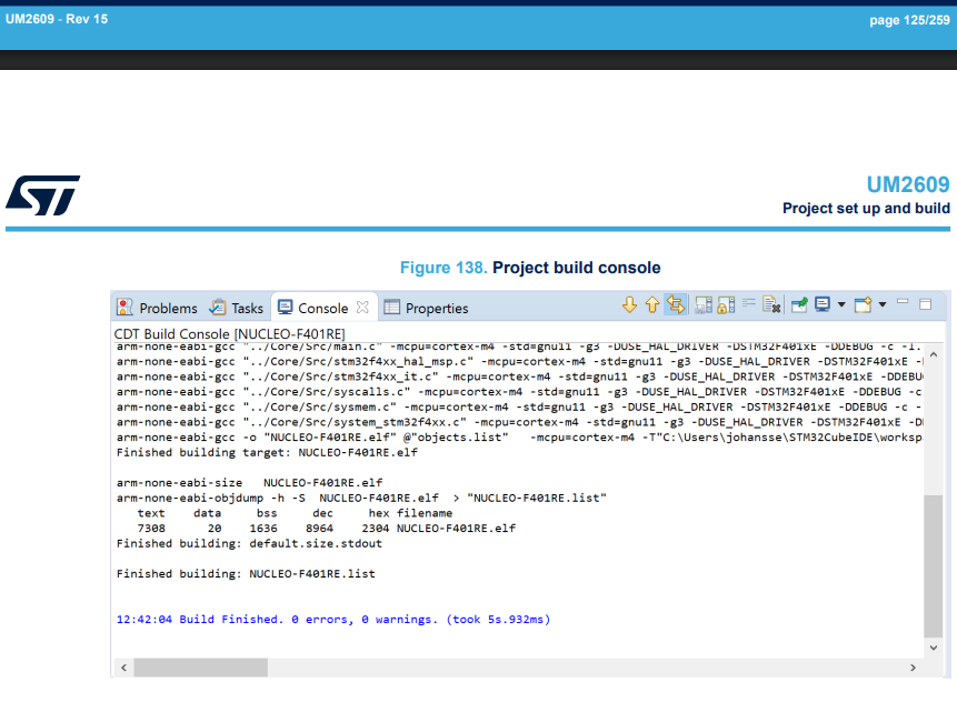

Even when there's nothing to build (everything is up-to-date), you should at least see something like this:
More generally, something like this (from the User Manual):
https://www.st.com/resource/en/user_manual/um2609-stm32cubeide-user-guide-stmicroelectronics.pdf#page=126
via: https://www.st.com/en/development-tools/stm32cubeide.html#documentation
If you're not seeing that, then that's a separate issue - start a new thread for that.

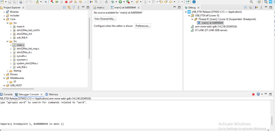

Now its showing some issue with build even though i removed the duplicate file. I guess the build was incomplete or something because every time am trying to run or debug , a new tab gets opened in editor showing this error.
What issues? Your screenshot does not show any build issues.
