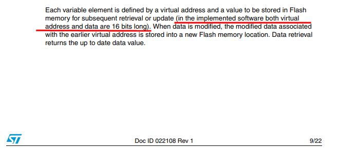

The so-called "Virtual Addresses" are just arbitrary tags to identify the data items:
https://community.st.com/t5/stm32-mcus-embedded-software/eeprom-emulation-virtual-addresses/m-p/675788#M47886
The data items are a fixed size.
EDIT:
In the AN3969 code, the data items are 16-bit:
So, if you want to store 32-bit data, you will have to split it across 2 "variables" in the emulated EEPROM - each with its own "Virtual Address".
Or re-write the code.
EDIT:
