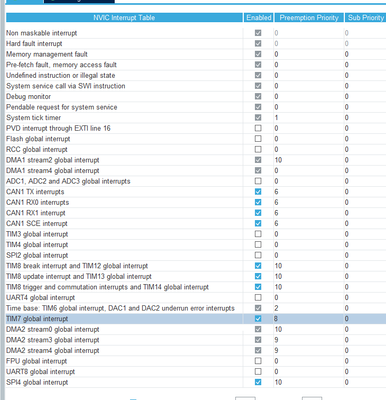

I have attached my ioc file.
DMA input and output stream are used during initialization process. The FreeRTOS scheduler is not yet started. But if interrupt priority is not compatible with FreeRTOS, an assert in port.c failed.
Perhaps our values for priorities are not good.
It seems the choice is very delicate.
Thank you for yours help.
                                       FWX.
@FWX
I see you have many peripherals that are configured with interrupt process.
You have a conflict with other interrupt. To debug the issue, you need to test the SPI transfer without other peripheral working on the setup. And then add them one by one.
The issue can be solved with a good management of interrupts priorities.
Could you try with interrupts priorities 5 for the two stream 3 and 4 please, this is to avoid conflict with CAN interrupts?
