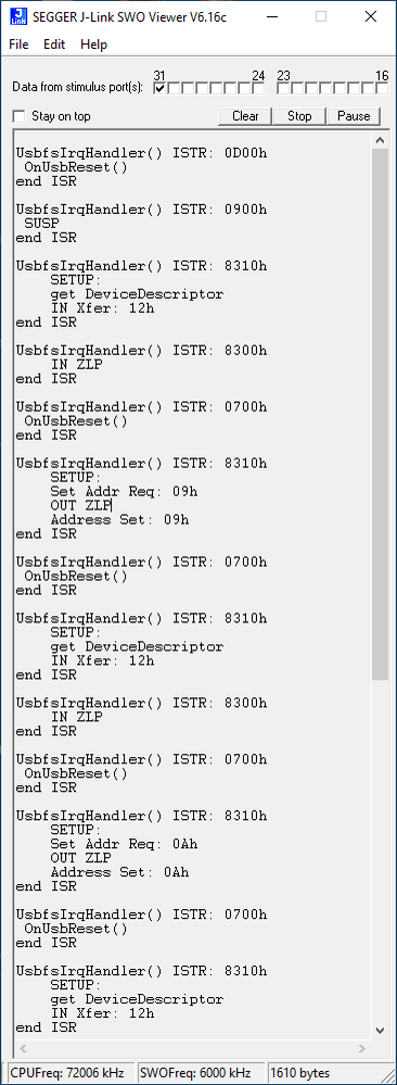

Workalot struggles. The struggle is with the STM32F37x USB peripheral. Clever Workalot has got USB enumeration to the stage of setting the USB address. Unclever Workalot is stuck there. Am hopeful a kind soul may gaze upon the included image...

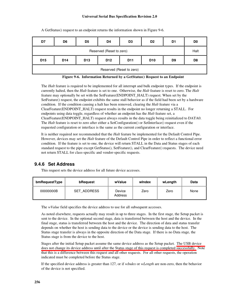

I take your point about Set_Address, it is a deferred action that is executed on the Status stage of the transfer. On the receipt of the Set_Address I store the address and then on the OUT ZLP (Status stage) I apply the address to DADDR.
Maybe once I clean out the bit-banded writes thinks will improve.

I've got progress in that address setting is about, enumeration starts but later stumbles. Windows reports a code 10.
