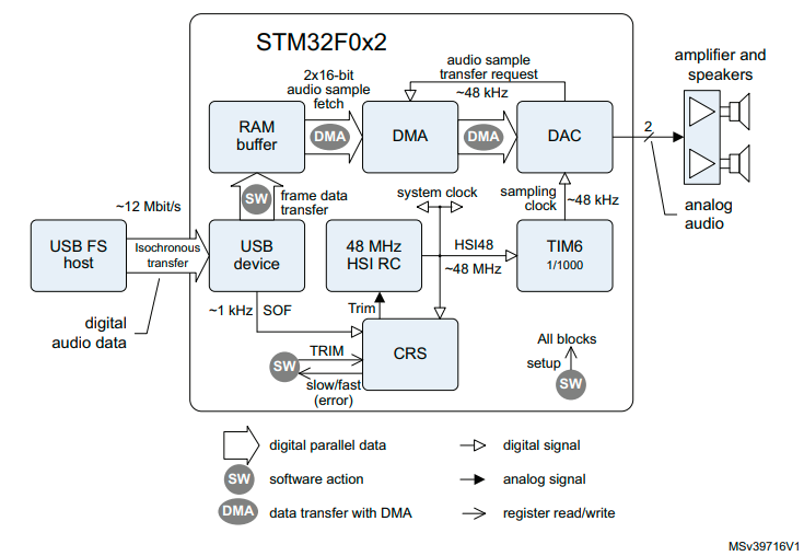

yes the sensor connects only with USB.
and when i was searching for the right STM32 MCU to get data from this connector, i found the STM32F0 that has inside a USB device as shown in the figure below.
is there any piece of help about this CLASS driver to base on or a helpful document to assume this USB communication?

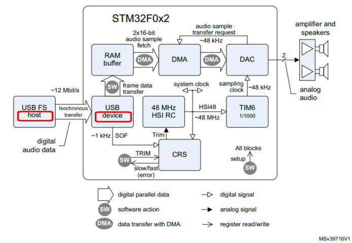

You know what you're doing?
In the headline you write about "microphone USB", in the description you mention a USB sensor.
USB device means that you can connect it to a USB host (for example a computer), not that you can connect other USB devices, such as your sensor.

> i have to read data from this sensor with STM32F0. via USB
You cannot.
As I said: STM32F0 is a USB device only, as far as I understand the STM32F0 website.
You need an STM32 with USB host / on the go capabilities, which the STM32F0 does not have.

A USB connection always consists of a Host, and a Device (ignoring Hubs for now).
Your sensor is a USB Device - therefore you will need a USB Host to connect to it.
As it says in the diagram you posted, the STM32F0 is also a USB Device - it cannot connect to another USB Device.
This is fundamental to the way USB works - it is not anything specific to the STM32
