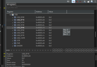

Hi, two questions:
1.- What config must set to PA11/PA12 pins? I set ALTERNATE FUNCTION (0x10) in MODER register, but what AF option must set? In STM32F373 manual there is no AF defined.
2.- I configure USB device (clocks/gpio) and i can access to USB registers as ADDR,... but EPs seems inhibed? you know the reason why?
Thanks a lot

JordiL
I did but have same result,
MX_USB_PCD_Init();
HAL_PCD_EP_Open(&hpcd_USB_FS, 0, 64, EP_TYPE_CTRL);
but EP0 no change values. EP0 -> 0x00.
I write bare metal and use debug (CUBEide) and i can't modify the Eps
How do you know?
You didnt tell which  board , usb hardware tested and working etc. -- so..?

4- Set USB->ADDR = USB->ADDR | 0x80; //Enable device
Theorically, now USB is ready to accept configure the EPns. But when i try to do it i can't change them.
Use same code with STM32F042 (but not config PA12/PA11 as alternate) and run properly.
Any Idea?
Use STM32373-Eval board in order to develope a USB driver.
If generate code with CUBEmx i have the same problem as if i write my own code.

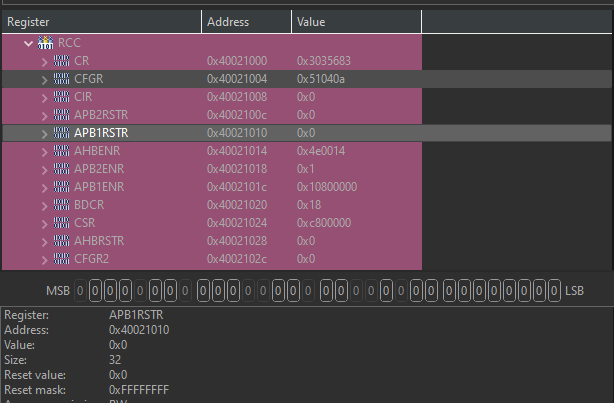

waclawek.jan
> i can't change them [USB registers]
Usually that means, that you don't have all the needed clocks running.
Thinks the same but theorically all clocks run as well
