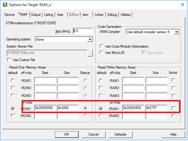

Hi all!
When i try startup my firmware from SRAM on stm32f103RE then nothing..
BOOT1 and BOOT0 is set to 1
Firmware developed on KEIL. Please, look my project settings:
int main(void){
__disable_irq ();
SCB->VTOR = 0x20000000U;
__set_MSP(*((volatile uint32_t *) 0x20000000U));
__DSB ();
__enable_irq();
init's and etc and main programm
1. I place my compiled firmware over ST-Link Utility on region 0x20000000 (upload dump and check it, all ok),
2. set BOOT1 & BOOT0 = 1,
3. and press RESET. Nothing! =(  programm does not work (not blinked).. does not startup
why?
thank

Posted on May 26, 2018 at 02:56
As discussed in other threads, over several years, the F1 has some special requirements with the placement of the Reset_Handler code. You will see 'BootRAM' in the GNU/GCC startup.s files for a given low, medium or high density parts. This is effectively a LDR PC,[0x20000004] instruction, but could just be your handler code.
https://community.st.com/community/stm32-community/blog/2018/05/13/boot-from-embedded-sram-mechanism-in-stm32?commentID=6232#comment-6232
Your main() function really doesn't have to do any of that. SCB->VTOR will be zero at reset, if SRAM is mapped at zero (and you can't change it on the F1, everything will be fine). Usually SCB->VTOR is set in SystemInit()

Posted on May 26, 2018 at 13:17
>>all work fine
No doubt, the debugger completely changes the dynamics, you are fighting specific conditions in the hardware that occur in a real reset.
Posted on May 26, 2018 at 13:33
If the part expects Reset_Handler to be at 0x200001E0 then it is not going to work if your build puts it at 0x20001234 or 0x2000120
Place ' DCD 0xF1E0F85F' at the end of the Vector table space, so it falls at 0x200001E0, to permit operation in this mode.
Look at STM32Cube_FW_F1_V1.6.1\Drivers\CMSIS\Device\ST\STM32F1xx\Source\Templates\gcc\startup_stm32f103xe.s
Attached (use Thread View) is a startup_stm32f103xe.s for Keil modified to permit RAM Booting

Posted on May 26, 2018 at 21:50
Cool!! it is worked!!
but i place
DCD 0xF1E0F85F with lead zeroes for align end of vector table in my startup
thank you, Clive for it magic
