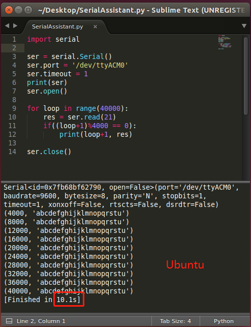

Sorry, i am come back. Recently, I tested my code again. I used stm32f103 to send data to the PC via USB CDC at a frequency of 4000Hz. And then I found that only 1000 packets can be received per second on Windows7, but it can normally receive 4000 packets per second on Ubuntu via CuteCOM. Do you have any advice? Thank you.
I use python to test, and the result is:
