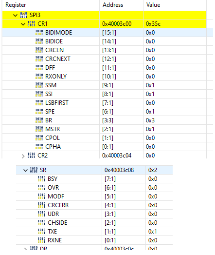

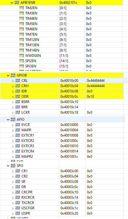

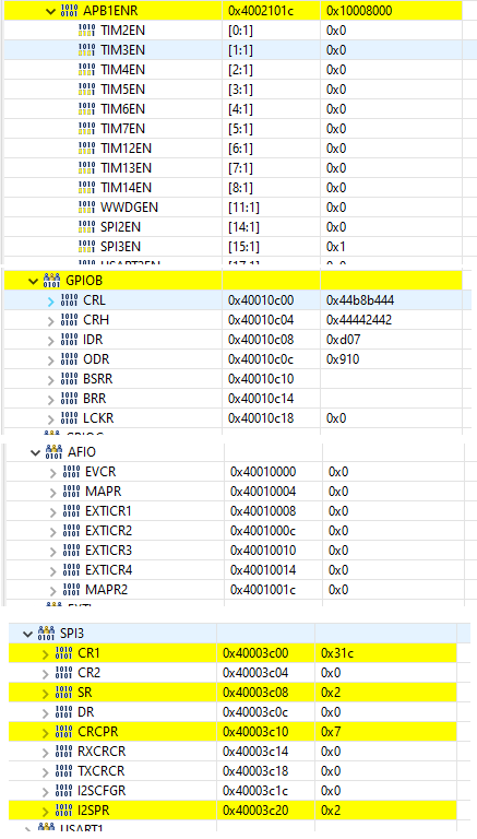

Which 'F1 exactly? And which 'F0 exactly?
Read out and check/post content of SPI and relevant GPIO/AFIO registers.
Thank you for reply 
STM32 model is STM32F103RCT6
Registers before init:
Registers after SPI init:
_legacyfs_online_stmicro_images_0693W00000bj815QAA.pngRegisters after transmit:
_legacyfs_online_stmicro_images_0693W00000bj81AQAQ.png Is it correct?

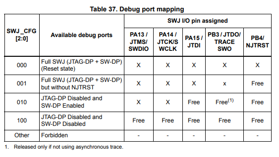

SCK is also SYS_JTDO so I add to HAL_MspInit:
__HAL_AFIO_REMAP_SWJ_NOJTAG();
After that SCK toggle too. When I turn on SPI I don't have any signal again :\

I disabled JTAG in HAL_MspInit function, so before SPI init, but...
I aslo want to use PB4 as GPIO so I added "__HAL_AFIO_REMAP_SWJ_NONJTRST();" too.
Then I have value 0x060 in SWJ_CFG register.
I find table in RM0008 where is no 011 value. So I use only "__HAL_AFIO_REMAP_SWJ_NOJTAG();" and now SPI is working.
