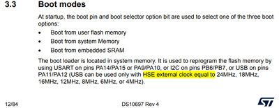

We have a STM32070CBT6 with minimal connections (schematic below) and it appears to be unresponsive to USB enumeration, although it does pull DP low to trigger it. This occurs when hotplugging it or holding reset low for a few seconds. I've checked the input on PF0 and it is getting a clean 16 MHz.

I'm not sure the bootloader works with external oscillator.

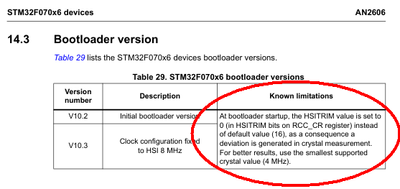

Are any hints in errata or AN2606?

Hi @waclawek.jan @liampwll
It is mentioned that bootloader over USB can be used only with HSE external clock (4MHz, 6MHz..)
I had seen a similar issue on F070, and workaround adopted was to insert a FS hub.

Hi @FBL ,
Both these issues are interesting and rise further questions...
waclawek.jan
This may be the root cause of problems both with USB and UART (with no external oscillator).
The same issue is there for 'F042. That it works may be a coincidence, as exact effect of HSITRIM is process-dependent, (complicated by the fact that HSITRIM is added to the factory-set HSICAL, and their combined effect will be some 5-10% off nominal, I guess) and varies from piece to piece.
There may be no sane solution(*) for the USB case. For UART case, you can try a couple of baudrates around (below) the nominal, if you have such control over the PC-end of software.
