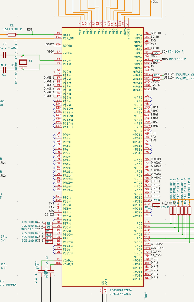

Hi everyone,
I’m working with a custom made STM32F446ZET6 board that otherwise functions perfectly (all peripherals, flash programming, etc. work fine). The only thing that doesn’t is the ROM bootloader. I can’t get USB DFU or UART boot to respond no matter what I do.
What I’ve verified
  • BOOT0 = 1 (3.3 V) at reset
  • NRST pulled high, no reset loops
  • VDDUSB = 3.3 V, decoupled with 100 nF
  • HSE = Abracon ABLS-8 MHz-12 pF, started with 18 pF load caps and lowered to 10 pF as I saw in a post here this might be the cause
  • PA9 connected directly to VBUS (5 V)
  • PA11/PA12 wired to USB-FS D−/D+ (verified routing and continuity)
  • Board runs normal firmware from Flash with no issues

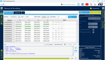

hello @samprince
I tested Nucleo F446ZE development board (MB1137) by first setting the BOOT0 pin to a high level (3.3 V) and then performing a system reset(reset using the reset button). After the reset, I connected the USB cable to the CN3 connector (USB PORT) and plugged it into my PC.
Under these conditions, the board was detected in DFU mode by STM32CubeProgrammer, and the USB bootloader operated as expected without issues.
Additionally, I verified that the BOOT1 pin is either left floating or tied to ground, which is essential to ensure that the system memory is selected as the boot area when BOOT0 is set high.
This configuration ensures that the MCU boots from the internal system memory (ROM bootloader) rather than from user flash or SRAM.
Capture of the Test
Hamdi Teyeb

Also, your PA11/PA12 are swapped. PA11 is USB_DM and PA12 is USB_DP. Brings into question how USB is working at all.
Thanks for the clarification TDK. I wasn’t aware that the DFU bootloader doesn’t actually depend on PA9 for VBUS sensing. That’s good to know, but I’ve now tried all possible states for PA9 (5 V direct, voltage divider, 3 V, and left unconnected) and none of them changed the outcome. D+ still goes high only when I force the ROM execution manually, but the host never enumerates the device.
Regarding PDR_ON, on my board it’s tied directly to 3.3 V with no capacitor. The power rails and sequencing are otherwise stable, and the MCU runs perfectly fine in normal operation, so I don’t suspect a general power issue, though I’ll add a small cap there in the next revision.
As for the swapped PA11/PA12, yes good eye, I made a mistake in the schematic drawing, so on the board they’re physically crossed to accommodate for my *** up, so the wiring to the USB connector is correct.
