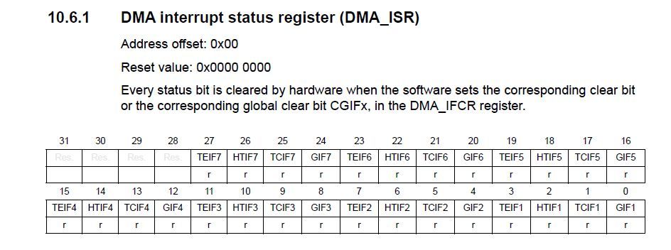

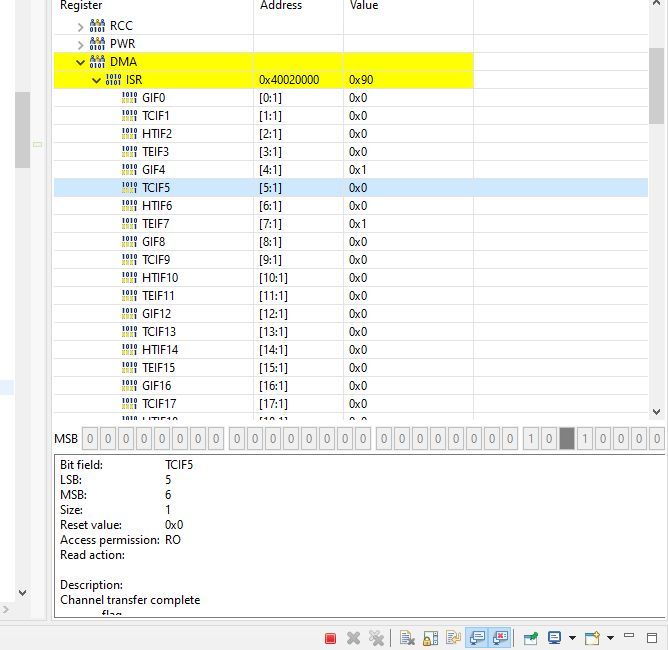

Project for STM32G071 (Nucleo), Bit names in SFRs wiev for DMA->ISR has wrong numbering.
Imen Ezzine
Hi mdudka9 ,
Just to update you that the needed fix is done on G071 and will to be replaced in upcoming version for STM32CubeIDE with correct SVD file.
regards,
-Imen

Imen.D
Hello @Michal Dudka​ ,
Thank you for bringing this issue to our attention.
I have passed this along to our development team for fix.
Imen
