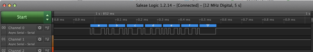

I would like to write a simple uart transmission using dma.
I see the transmitted data with a logic analyzer. All looks good.

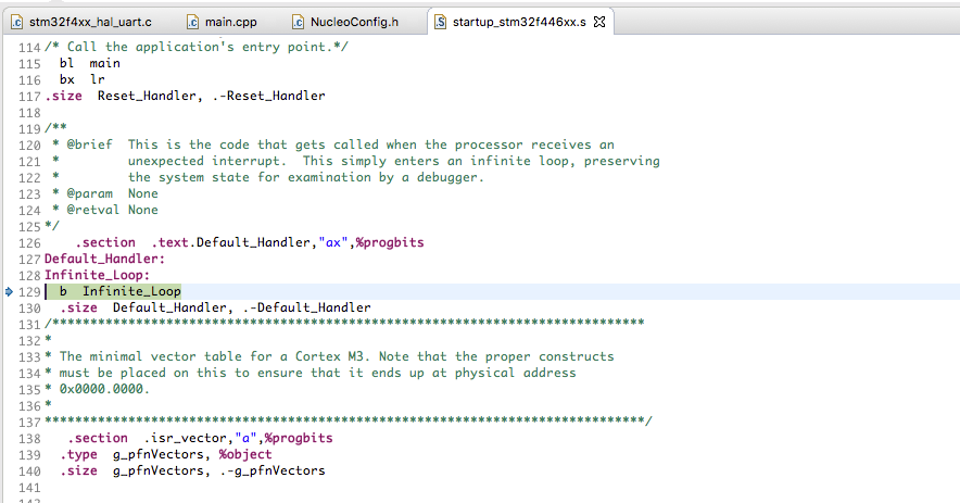

But, Interrupt functions USART6_IRQHandler, DMA2_Stream7_IRQHandler, HAL_UART_TxCpltCallback, HAL_UART_TxHalfCpltCallback, doesn�t call.
If i suspend, the program ends every time in an infinite loop in file startup_stm32f446xx.s

2017-10-01 9:55 AM
You're using a .CPP file, so you'll get name mangling on the functions and no linkage to the vector table.
extern 'C' void DMA2_Stream7_IRQHandler(void){

HAL_DMA_IRQHandler(&hdma_usart1_tx);}2017-10-01 3:59 PM
perfekt! it works!
