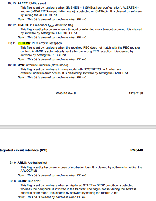

- On another note, it looks like the interrupts are not always cleared in accordance with **RM0440 Table 394**:
  - In the error section, I2C_FLAG_PECERR, I2C_FLAG_TIMEOUT, and I2C_FLAG_ALERT are never cleared.
  - Also in I2C_Master_ISR_IT.

These flags "I2C_FLAG_PECERR, I2C_FLAG_TIMEOUT, and I2C_FLAG_ALERT" cannot be cleared by software. They are cleared by hardware when disabling the peripheral.
