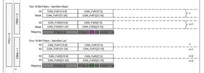

I am currently using a STM32l433 with the following configuration:
        CAN_FilterTypeDef  CAN_FilterInitStructure = {0};
        CAN_FilterInitStructure.FilterBank = filterNum;
        CAN_FilterInitStructure.FilterScale = CAN_FILTERSCALE_16BIT;
        // 11-bits StdId left-aligned on the 32-bits word register
        CAN_FilterInitStructure.FilterIdHigh = id << 5;
        CAN_FilterInitStructure.FilterIdLow = 0;
        CAN_FilterInitStructure.FilterMaskIdHigh = mask << 5;
        CAN_FilterInitStructure.FilterMaskIdLow = 0;
        CAN_FilterInitStructure.FilterFIFOAssignment = CAN_FILTER_FIFO0;
        CAN_FilterInitStructure.FilterMode = CAN_FILTERMODE_IDMASK;
It globally works. So if my ID is 0x701 and my mask 0xFFFF, the callback will be called for every message ID 0x701.
However, when I change the mask, for exaple to a value like 0x700, in order to only get the '7' from the standard ID, my callback is not called for every message with ID 0x7__.
I also notice the that the 16bit filter lenght require the RTR, IDE and EXID (see picture below). In my case everything is set to 0. Could it be those settings are wrong ?
Could it be that there is something wrong with the configuration that makes the mask invalid ?
Any help is appreciated !
Thanks

mƎALLEm
I'm not sure what are you planning to do but if a bit in the mask is set to1 that means the filter must accept the corresponding value if the bit set in the ID.
For example, if the ID = 0x701 and the MASK = 0xFFF, this means that only the 0x701 ID will be accepted by the filter.
If you need all the IDs: from 0x700 to 0x7FF to be accepted you need to set the MASK ID = 0xF00.
0 in the Mask ID means don't care.

In fact in 16 bit mode you have two batch of filter configs:
- One is set in the High part and another in the Low part. For example we can set this configuration to receive all the IDs from 0x700 to 0x7FF and one from the ID = 0x300:
    sFilterConfig.FilterMode = CAN_FILTERMODE_IDMASK;
    sFilterConfig.FilterScale = CAN_FILTERSCALE_16BIT;
    sFilterConfig.FilterIdHigh = 0x0700<<5;
    sFilterConfig.FilterIdLow = 0x0300<<5;
    sFilterConfig.FilterMaskIdHigh = 0x0F00<<5;
    sFilterConfig.FilterMaskIdLow = 0x0FFF<<5;

Regarding your question:
"I also notice the that the 16bit filter lenght require the RTR, IDE and EXID (see picture below). In my case everything is set to 0. Could it be those settings are wrong ?"
In the filter configuration we shift left by 5, so only the ID itself is impacted and all type pf frames RTR, and extended could be accepted by the filter. If you need to be more selective you need to set their bits according to the figure you shared.
Hope that I've answered your question.
