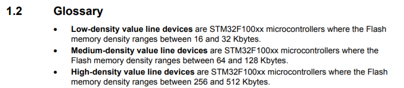

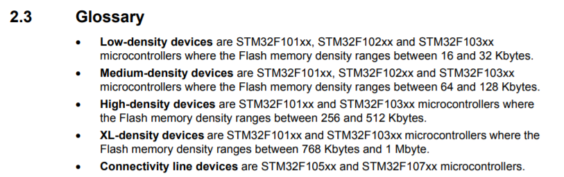

Hi @Senax​ ,
In the Glossary of RM0008, you find the following explanation:
0693W00000FAhXIQA1.pngA complementary explanation for value line (vl) in RM0041:
0693W00000FAhYpQAL.pngSTM32F103RB is a medium density device (128Kb flash), so you will have to select startup_stm32f10x_md.s.
