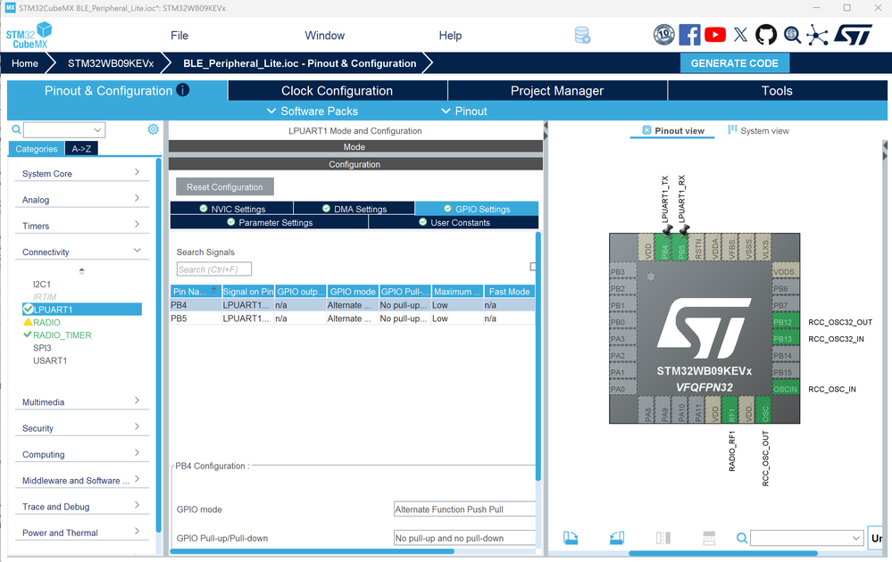

I am testing with NUCLEO-WB09KE EVB
Started from the example code ; "BLE_Peripheral_Lite", which is using PB0/PA1 as usuart port
I can see the Uart output signal on MB1801, CN3.37.
Then I manipulate to code to use LPUART; PB4/PB5 [attached code: BLE_Peripheral_Lite_LPUART1_PB4PB5.zip]
But the result is, Uart output signal is still on MB1801, CN3.37(same PIN with USART).
Did I do something Wrong? or Missed something?
Please Help

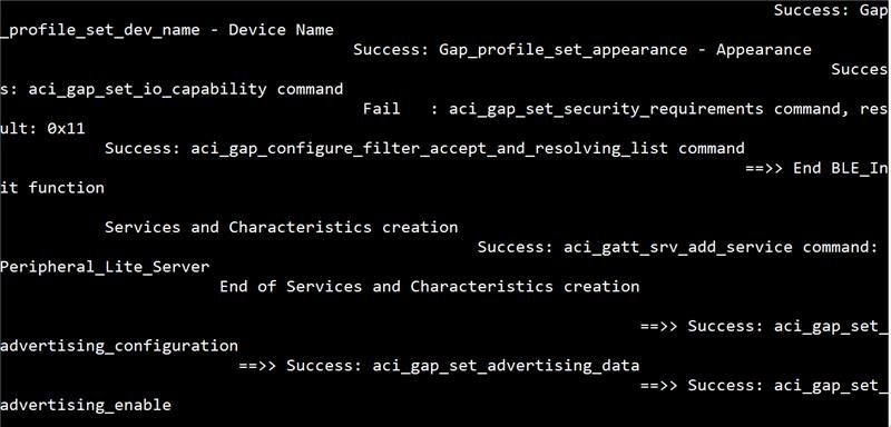

Just as an aside, you need to configure your terminal so that it starts a new line (ie, does both LF and CR) when it receives a LF.
Then you won't get the lines disappearing off to the right - as they are in your screenshot.
@Andrew Neil Thank you for advice but this is not what I expected.
the code is based on the original example code. I tried to minimize the modification
I was talking about your terminal configuration - not modifying the software.
@Andrew Neil  Oh. Okay I misunderstood. I changed the config
Andrew Neil
Have you tried a simple, basic example which just does output to the LPUART on PB4 & PB5 - nothing else ?
I would suggest that you do that first, to prove that you have basic connectivity.
Once you have that working as a reference, then you can look at how to merge it into the BLE application.
