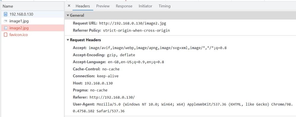

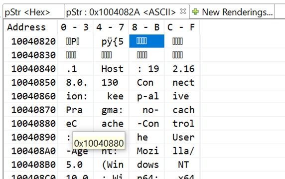

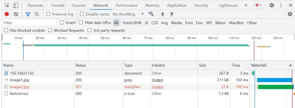

But when the code below was called for “image2.jpg�? I found “buf�? is normally corrupted with leading zeros.
netbuf_data(inbuf, (void**)&buf, &buflen);
Looking at the “buf�? I can see the original HTTP request, but the ETH driver/DMA/?? has overwritten the start with zeros.
Looking at the web browser I can see the actual request is valid.
When the web server sees an empty string it returns back with 501, and the image is not loaded.

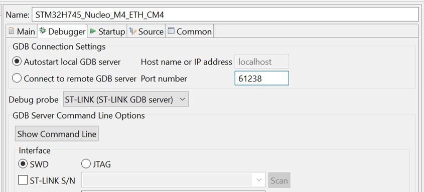

I’ve included the whole project as a zip file. If you debug it you need to change one of the debug configurations to use a different GDB port number, eg 61238, otherwise it will clash.

2023-03-19 4:04 PM
Hello Team,
I done the same in new firmware in STM32H745ZI-Q (M7) as mentioned the same configuration of ethernet stack and it seems to have the same issue during the display of webpage.
New project was created with the mentioned configuration and seems that I'm unable to see images.
Please let me know incase of any configuration issue from my side or is there any latest bug fixes coming from ST to solve the issue.
Project attached.
