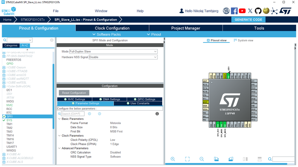

I have setup a SPI master and a SPI slave, both use DMA in Normal mode. The word size is 8-bits and the data size is 8-bytes. The problem is that the slave transmits messages which contains old data.
When it should send:
MISO: { 0x01, 0x01, 0x01, 0x01, 0x01, 0x01, 0x01, 0x01 }
it sends:
MISO: { 0x00, 0x00, 0x00, 0x01, 0x01, 0x01, 0x01, 0x01 }
MISO: { 0x02, 0x02, 0x02, 0x02, 0x02, 0x02, 0x02, 0x02 }
it sends:
MISO: { 0x01, 0x01, 0x01, 0x02, 0x02, 0x02, 0x02, 0x02 }
OBS: The debug gpio is toggled when the ISR finishes and when theTxBuffer is edited in main.
This pattern continues for every transfer it contains 3 old bytes.

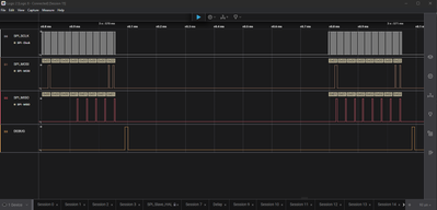

‎2024-06-19 5:56 AM
Ideally I would implement sequential first and then concurrently.
The first screenshot i posted from the logic analyser it showed that the TxBuffer was processed way before the next transation began. How can it be that I still see old data in the firste 3-bytes of the transfer?Logic Analyser

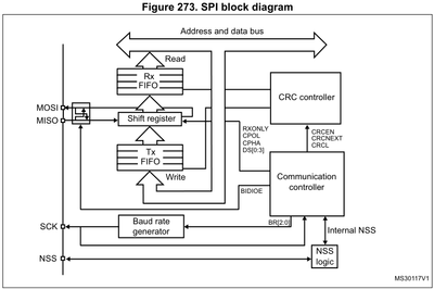

The reference manual (for STM32F031, rm0091) states that the SPI Tx Buffer can contain 3-bytes. When DMA is initiated it bumps the DMA_CNDTRx register from 8-bytes to 5-bytes likely because it transfers the first three bytes to the SPI TxBuffer which is illustrated in the block diagram below.
When I try to update the TxBuffer by setting up a new transfer I think that it is this FIFO that doesn't get cleared properly from the previous transfer. I am having a hard time debugging this as I haven't found any register or flash address for the TxFIFO & RxFIFO.
I am working on a setup with tight timing requirements, why I cannot use FreeRTOS. Can you point me to any ressources with double buffering in embedded systems, or do you have suggestions any insights on the SPI TxBuffer, that might not be cleared properly?

‎2024-06-19 10:29 AM - edited ‎2024-06-19 12:53 PM
Update: PPopo.1 just told you what the issue is. You should not have calls to HAL_SPI_TransmitReceive_DMA in both your callback *and* your main loop.
> Can you point me to any resources with double buffering in embedded systems,
IMHO you should not try implementing a more complex design until you fully understand why your current one isn't working. Instead of adding complexity (adding more sync variables, more conditionals, switching to double-buffering), you should be trying to simplify as much as possible until the source of the problem becomes clear (like draining a pond to catch a fish).
You can certainly check the silicon errata for you chip, but if there isn't something there assume this is not the issue.
