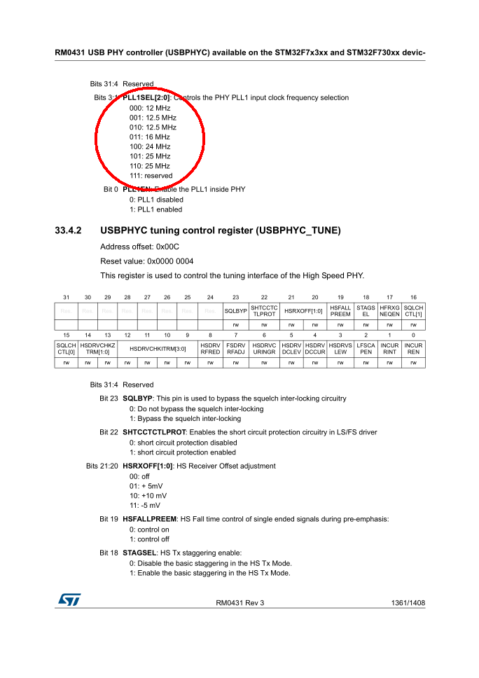

I finally solved the issue. It was a combination of 2 things.. on my custom board I used a 8MHz crystal to clock the stm32 (with all the proper clock configuration), however I found out today that in the file stm32f7xx_ll_usb.c, in the function static HAL_StatusTypeDef USB_HS_PHYCInit(USB_OTG_GlobalTypeDef *USBx), there is a section which controls the PHY frequency selection.. there are only conditionals for certain HSE frequencies, which are 12, 12.5, 16, 24, 25 and 32MHz. So I tried changing the crystal to 25MHz, reconfigured the clock config and it immediately started to enumerate the memory stick. Apparently this is not documented anywhere.
Are you sure with the 32MHz?

Hey there, thanks for the reply!
If we look at the actual stm32f7xx_ll_usb.c file, there is actually a define for a 32MHz HSE. Check this out:
‎2022-08-07 4:37 PM
I meant that the fact that not all crystal frequencies can be used "out of the box" to get the USB HS working properly, is what is not documented anywhere in a comprehensive manner hehe.

Hi @Amel NASRI​ ,
Can please this discrepancy between RM and the library be explained?

I am supposing maybe it is a typo in the reference manual in the PLL1SEL bits selection? Maybe one of the options should be marked as "32 MHz"? The "110: 25MHz", maybe needs to say "110: 32 Mhz" instead?
I do not have a 32MHz crystal to confirm if it would work.
