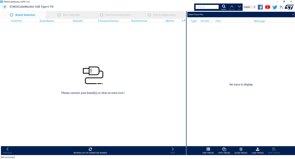

the code is compiled without problem, it seems to run (no hardfault error) but i can't find the board in the cube monitor UCPD

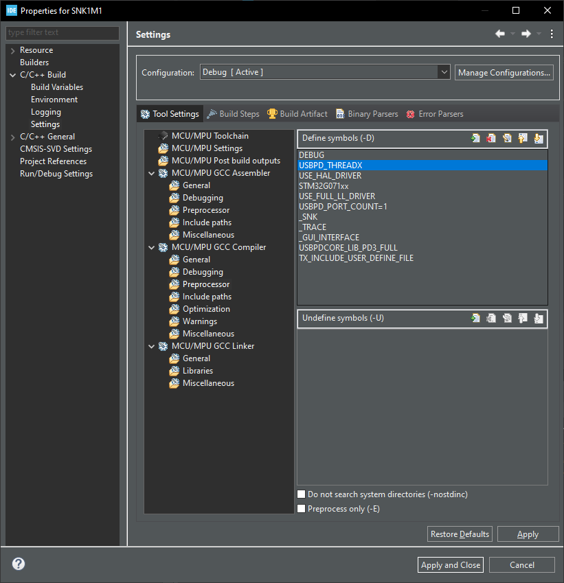

USBPD_THREADX can be added as predefined symbol to be used by Cube Monitor UCPD to integrate code that is specific to the ThreadX. Then, using _TRACE and _GUI_INTERFACE, traces in UCPD monitor can be accessed.

but where i have to click to open that page on cube monitor UCPD?
Founded @FBL
i have added the symbol in the project properties MCU/MPU GCC Compiler -> preprocessor
i have tried but nothing changed.. always unable to see the com port in the cube monitor
