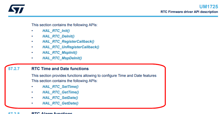

Hello everyone, i am working on a software for setting the date and time.
The plan is to set the date and tame manually (so no defficulties regarding that) and then continue to increase within the time flies thanks to the RTC of the NUCLEO F401RE.
Do you think that would be possible ? Would it be a simple way to set the date and time, by directly using the RTC with HAL libraries for example ?

 The HAL gives you functions to set the RTC Time & Date:

Hello @willow
I suggest you to refer to the following example, it should works on Nucleo-F401RE.
STM32Cube_FW_F4_V1.28.0\Projects\STM32F410xx-Nucleo\Examples\RTC\RTC_Calendar

Thank you Romain for your fast answer, is this a STM32 software that i have to download ?

thank you very much for the tools given ! Im gonna check everything !
