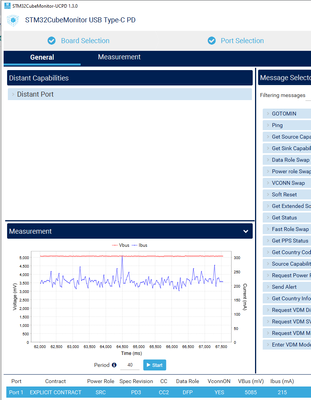

One more doubt, Can i take advantage of the inbuilt screen for monitoring the power consumption via USB PD?
Thanks in advance
Nithin
Nicolas P.
Hello @NITHIN,
You want to display board power consumption on inbuilt screen ?
It would perhaps increase the power consumption a bit ? How precise do you want to be ?
And what do you mean power consumption via USBPD ?
If you want to have the details of the power delivery contract, you can have that on the UCPD monitor.
Are you aware of this tool (wiki link)
You can display VBUS voltage and current :
Or even use the trigger button to display some info in the trace : see this part of the wiki
