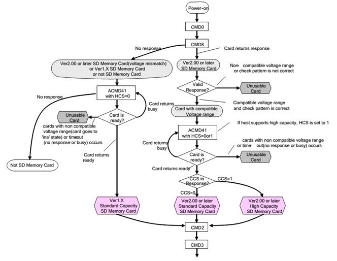

OK, I haven't solved it, but I have found a clue as to what is going on.
I traced the problem to the SD_PowerON() function. When it sends CMD55 (APP_CMD) it returns 'illegal command'. But that command is a legal command in all SD cards. I have a copy of the simplified 1.0, 1.1, and 2.0 SD specs and it was a mandatory command in all of them. These are microSD cards, marked with 'SD' on them so are clearly not MMC cards. So they must support the CMD55. They are probably v 1.0 or 1.1 since they are 1GB and 512MB.
Just before sending the CMD55 in the PowerON() function it sends CMD8 which, if it gets a good response, shows that it is an HC microSD card as opposed to a standard one. But CMD8 is an illegal command in the standard (ver. 1) cards.
So I commented out the code that sends the CMD 8 (and it's response). Now it works. The CMD55 works. As do the rest of the commands initializing the card. And so does the rest of my code reading and displaying the file names of the files in the directory on the card.
So something about sending that CMD8, illegal command, before sending the CMD55 is causing the issue. There must be some kind of error code or status that is not getting cleared between the two.
Anybody know this SDMMC device well enough to hazard a guess what is going on???

‎2017-03-16 5:18 PM
For SDv1 Cards and MultiMediaCards,should be send CMD0 to return idle state once after CMD8 banned.
But ST Codesabruptly
try to send CMD55 + ACMD41.- Mark as New
‎2017-03-19 1:26 PM
That sounds logical. However the flow chart in both the Simplified SD Host Controller Spec v2.0 and in the Physical Layer spec 5.0, for the Card Initialization and Identification flow chart, both show that if the CMD8 gets no response they then go directly to the CMD55/41.
I don't have a logic analyzer handy, but I would like to look at the actual response coming back from the card for the CMD55 right after the CMD8 to see if the card is actually sending an Illegal Command bit with the response to the CMD55 or if that is something left over in the SDMMC interface from the failed CMD8. That would clarify if it's a bug in the STM hardware or in the SD Card spec flow chart.
