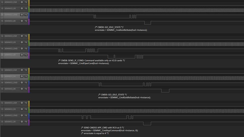

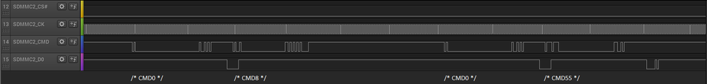

I'm aware this SD-card question appears beaten to death but from all postings I've read most appear to be SPI related, which I'm not using as trying to use SDIO comms. Having tried my best for over a week now, I feel it's about time I reached out.
I think one of the biggest areas of confusion for me is the output of the SD-card in my setup under two scenarios: running and step-by-step debugging; the former appears to be truncating the output of the card while the latter shows the full response - please see images attached:
Normal running....
Step-by-step debugging....
