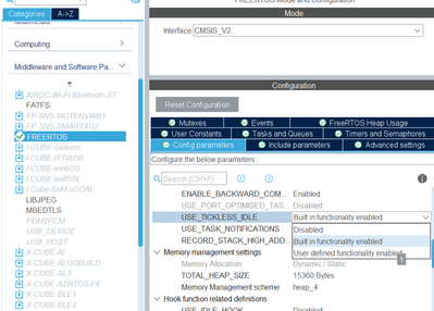

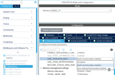

I am workin on FreeRTOS with STM32f411CEU6 Blackpill.

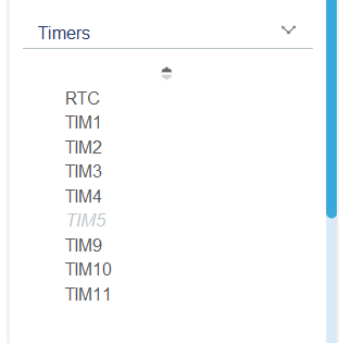

In this I am facing issue with using sleep mode because there is no pin LPTIM1 in the section of TIMERS.
I tryed bothe of them CMSIS_V1 and CMSIS_V2.
Is there aany Way to use SLEEP MODE

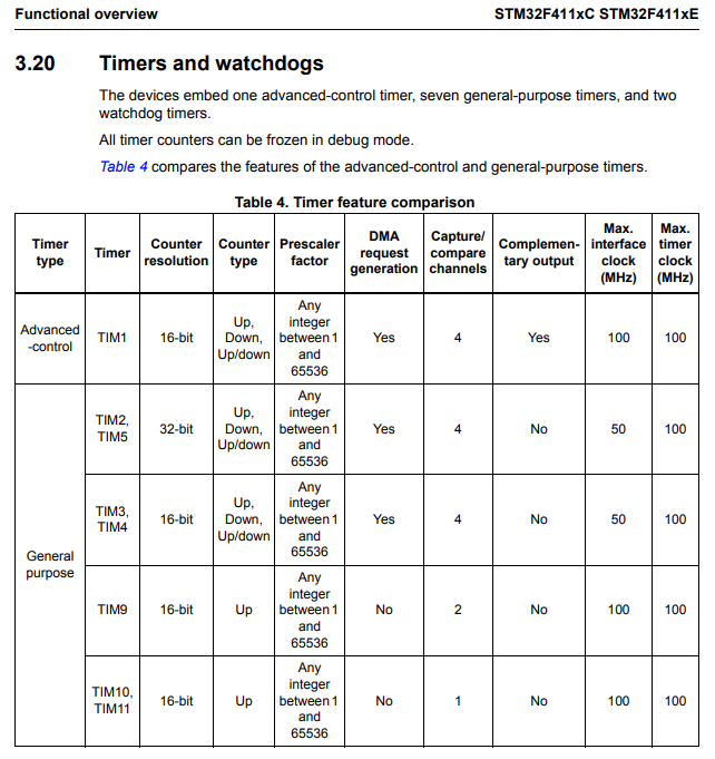

Use one of the timers which is available!
RTC might be an option?

@Kai_Satone wrote:
 STM32f411CEU6 ... there is no pin LPTIM1 in the section of TIMERS.
That chip doesn't have an LPTIM1 timer:

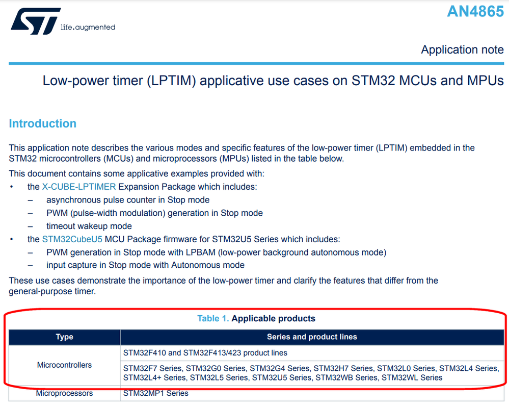

To reach stop modes you can use LPTIM or RTC clocked by LSE... typically, the RTC has a resolution of 1 sec, which is inappropriate for most cases. it is mostly used in deeper sleep modes and not in sleep mode.
I would as well suggest upgrading to another STM32 as @Andrew Neil said the blackpills are mostly fake!
There are quite range of affordable Nucleo boards with LPTIM, for instance you can choose a NucleoL0 or L4

Chips which do have LPTIM:
So an L4 would be the closest to  what you have ...
