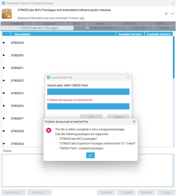

I need to import X-CUBE-OPUS on STM32CubeIde.
I have tried to use the embedded software manager in STM32CubeIde but it did not work.
My goal is to create a project from scratch and after add these middlewares.
What is the correct procedure to do it.

As your request the version of the  my STM32CubeIDE is  1.15.0 (The Last released)

Further to your comment, I can confirm that the issue is related to the pack file. It does not include the STMicroelectronics. X-CUBE-OPUS.pdsc. Thats why the file is not recognized as a package.

How can i include these middlewares in my code from scratch?
