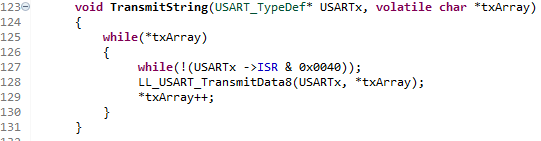

0693W00000AOIHrQAP.pngHello,
I am experiencing some problems when trying to receive data from PC using UART and then check if it is correct. I am using using LL API and this code is placed in while(1) of main function. For example, when I send 'A' from PC to STM32, PC receives response with '0x01' but if I try to send 'A' again, it does not respond anymore. Do I have to clear some flags of USART before receiving again?
Thank you

I noticed that LL_USART_TransmitData8 function successfully transmits chosen value every time when data = 'A' is received:
But now I want to transmit a string:
TransmitString function:
And the problem is that string is transmtited only one time when first time data = 'A' is received. When data = 'A' is received again, nothing is transmitted. Could you help me to solve this problem?

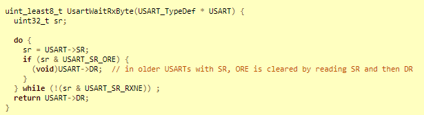

waclawek.jan
Which STM32?
Maybe receiver stops working due to unhandled overrun error?
I use STM32L011. I will try to check if this code of overrun error correction helps. Thank you.
Indois
How should I use this function?
It blocks receiving data if I start it in while, before data=LL_USART_ReceiveData8(USART2).
