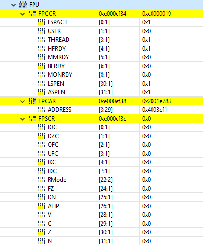

We spent yesterday examining the faulty build, fault registers of exception I already posted in June 10, 2019.
First we thought that the odd value in LR was the reason to the exception, and it took a while for us to understand that some library functions are using the register for their own purposes and the actual return address is popped from the stack.
We also learned that stack was not overflown - as it never was in the earlier exceptions either. There were no interrupts active at exception point.
What we learned - with this specific build - is that the line where the exception occurred is the following:
90001ed6:  blx    r7 // atof call
90001ed8:  ldr    r6, [pc, #64]  ; (0x90001f1c <MC60E_Gnss::ParseGGA(char const*, unsigned long)+228>)
90001eda:  vmov   r0, r1, d0
90001ede:  blx    r6
and the usage fault reason for the exception is: Attempt to execute a coprocessor instruction (NOCP)
and this is the line - which indeed seems to be a coprocessor instruction - that already has been run several times before the exception occurs. It has also been calculating the correct floating point values. Stack and register values seems to be correct in the exception point.
Can you reproduce this fault? If yes, can you then read out the content of SCB_CPACR?
turboscrew
Senior III
That's why I pushed to check the CFSR.
The CPACR, Jan Waclawek mentioned, has a bitmap telling which coprocessors are implemented. FPU is implemented as coprocessors 10 and 11.
You might also want to check FPCCR.
BTW, when you have problems with core (as opposed to peripherals), Arm-manuals are more "it". In your case: https://static.docs.arm.com/ddi0403/eb/DDI0403E_B_armv7m_arm.pdf

Here are some register values from the crashing point:
0690X000008idmDQAQ.png0690X000008idm8QAA.pngto us they seem to be quite normal - though our understanding on this area is not on very high (if any) level.
In our compiler settings the FPU is FPv5-SP-D16 and - as said before - the calculations are performed successfully and correctly until this crash occurs
