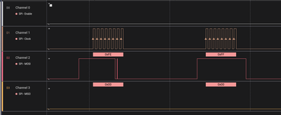

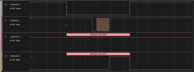

But it's not working at all. Using logic-level analyzer I have noticed something weird - bytes sent by SPI are delayed by about half a period of the signal. About, because it's not equal between the next attempts... I have set CPOL=CPHA=0 on both STM32H7 and the analyzer. If I change one side to CPOL=0 && CPHA=1 then I get the expected data (decoded) but only sometimes and only on the MOSI (0xD0 sent). The screens below show both situations.
CPOL=CPHA=0 Both
CPOL=0 CPOHA=1 One side
I have checked connections, I have checked the sensor (with the different MCU, not STM), and I have checked different pin configurations. I even tried to use AruinoSPI with PlatformioIDE. No matter what am I doing I'm getting similar results - random bits on the SPI...

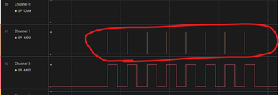

No problems with MISO signal. The MOSI signal is still garbage.
If you have nothing connected to that pin during this test, the hardware is faulty (or your logic analyzer channel is broken. Swap channels to eliminate that possibility.). You'll have to get a new board.
It might be informative to take an analog capture of this signal (the GPIO output toggling test on the MOSI pin), though it won't solve the problem.
I tried swapping pins but as "expected" - one channel is broken. After the weekend, I will try a different logic analyzer and then consider buying a new board. I'll let you know about the results. Thank you!
Oscilloscope pics are necessary, LA is good if software /protocol error, but pretty useless on this level of hardware debugging. You always can do loop back tests on the same SPI or cross-tests transmit-receive to-from another SPI on the same board.
RadoslawSajdak

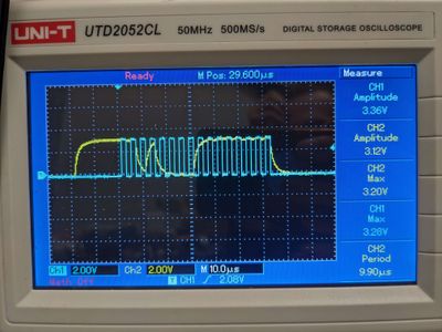

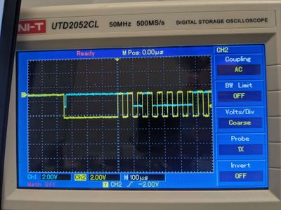

I got an oscilloscope and here's the result and other Logic Analyzer. Conclusion:
- Peaks came from a probably broken Logic Analyzer. Something was wrong internally, maybe just separation between channels.
- I noticed that every module I tried to use had pull-ups on every line (SCK/MISO/MOSI). After removing it I saw the correct signal BUT only in low-frequency signals. Let me explain with the pictures (sorry but my oscilloscope couldn't get a print screen...):

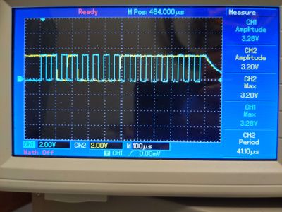

1) I achieved proper communication using both the HAL and registers approach.
a) BMP280 connected to the NUCLEO.
b) Pull-up resistors removed.
c) Oscilloscope probes connected to 2cm wires, soldered directly to the MCU.
d) Prescaler == 256 (15KBit/s)
e) Oscilloscope channel 1 - SCK; channel 2 - MOSI

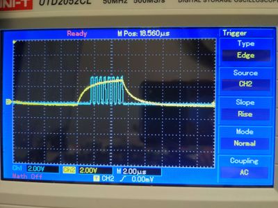

2) In my target project I will need higher SPI speeds. So I started to change it. Communication (digital) looks fine but I have noticed something alarming on the MOSI pin. The signal was affected by some capacitance.
d) Prescaler == 16 (250KBit/s)

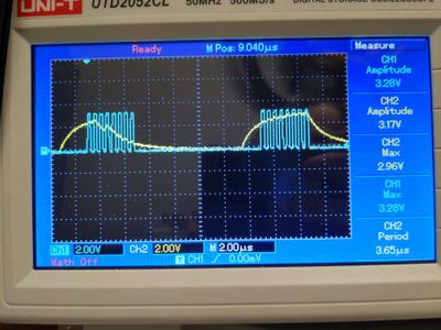

3) I changed the prescaler and now communication was impossible.
d) Prescaler == 2 (2MBbit/s)
4) I thought the sensor could cause it so I removed it. Nothing changed. Some capacitance on MOSI line broke the signal. So here's my first question: What could cause the capacitance on MOSI pin if nothing is connected?
a) BMP280 NOT connected to the NUCLEO.
b) n.a.
5) Then I soldered the resistors again and I got the result similar to that described last days. BUT Oscilloscope showed something weird. MOSI signal looked almost perfect but its amplitude was equal to half of expected. So when SCK was jumping between 0-3.3V, MOSI couldn't achieve 0V, oscillating between 3.3-2V. So if I manually wrote bits I got the expected 0xD0 but because 2V is too high to be recognized as LOW, I got 0xff and I couldn't communicate with the sensor. I have checked the sensor with atmega and it worked without any problems. So Do you have any idea, why MOSI with pull-ups couldn't go below 2V? I know SPI doesn't need pullup/down, but it should work with it. Especially with lower speeds. For me, it's not related because the signal is sharp and right placed.
b) Resistors soldered to BMP280 (SCK/MISO/MOSI; 10kOhm)
d) Prescaler == 256 (15KBbit/s)
e) Oscilloscope channel 1 - MOSI; channel 2 - SCK
It sounds like your MOSI pin is damaged, particularly the high-side protection diode. No fix for that but to get a new chip, or use a different pin.
Perhaps it was damaged by the same thing that damaged the logic analyzer channel, or perhaps the bad logic analyzer channel damaged it.
Double check that the MOSI pin frequency is set to very high, or set to the same as the SCK pin, but I doubt that's the problem.
@TDK You're right. The other pin works well with 2MBit/s. It doesn't matter how I set the pin frequency. How did you know that? Is the 2V value with resistors related? Or only because of capacitance?
