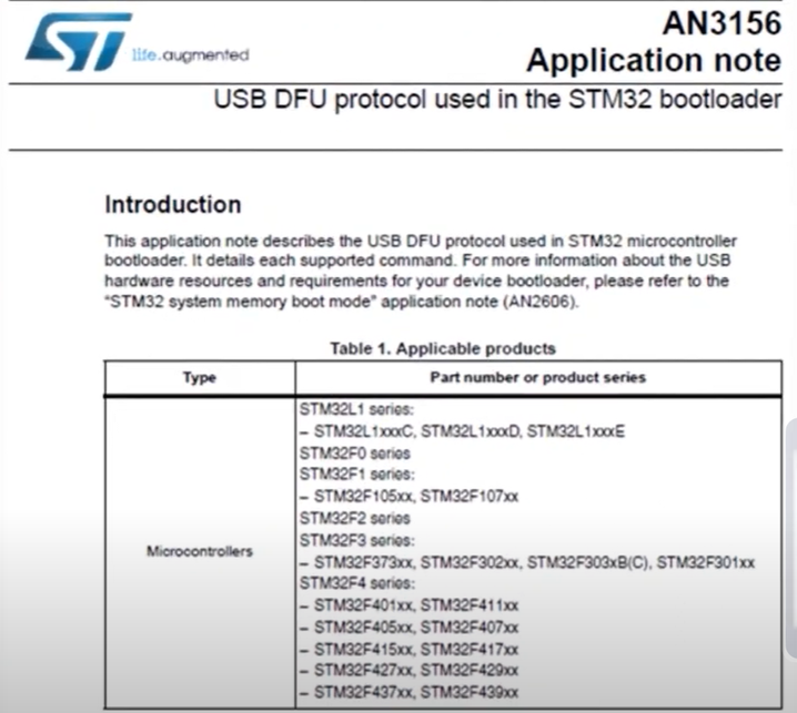

It is my understanding from watching this video from ST:
https://www.youtube.com/watch?v=Kx7yWVi8kbU
That many STM32 chips come with a built in bootloader in ROM that can be accessed by pulling the BOOT0 pin high.
However, I just took a couple of brand new STM32 blue pills out of the package and was not able to see the USB device enumerated, and when I opened STM32 Cube Programmer and select USB, it sees nothing and says "NO DFU DEVICE FOUND"
The blue pills are a super basic board and have jumpers to pull BOOT0 and BOOT1 high, so I would think this would work. ST Application Note AN3156 says that the STM32 chip on this board support the DFU built in bootloader, so I'm not sure what's going on here. Anyone have any light to shed on this?
More or better: all cpus...have a bootloader.
Read AN2606 about bootloader and its capabilities in different STM32 series.
So : you can start the bootloader (boot0 hi ) on a BluePill , but need a serial/TTL to USB adapter to connect to the uart1 on the F103C8 ( or CB) . No bootloader here on USB -> PC.

Your video 0:31 time show same info as AN2606 = only 105 107 have DFU. No 103 (bluepill).
But FYI for 103 exist user custom DFU bootloader projects...

Yeah i saw that, but that video's 9 years old and if you pull the newest version of AN3156 off the ST site (rev 15) from feb 2024, that table has changed:

As i already told you :
bootloader on F103CB = yes . But on uart , not on usb . So difficult to understand ?
‎2024-07-24 5:03 PM
Yes, I understand. Just saying, that this is not mentioned in the newest version of AN3156, nor does the video linked mention that some chips won't support USB on the DFU FW.
