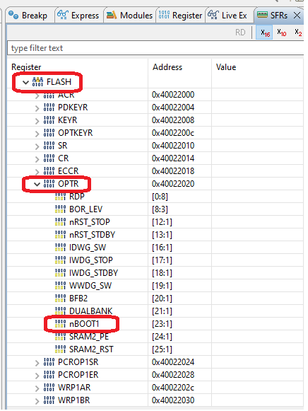

And about the ' FLASH_OPTR' register, in the STM32CubeIDE, for the MCU that I'm working with (STM32L4A6AGIX), there is no an field called nBOOT0 & nSWBOOT0, as shown in the attached picture.
So how can I configure BOOT0 now, that in a programmatically way, the MCU will load the burned program, from flash to adress 0x00000000, and will run the program after turning it on.

The option bytes are in addresses 0x1FFF7800-1FFF7820 (bank1)
On your picture are shown the flash control registers. They reflect the state of the option bytes in runtime.

Well, then I will kindly inform you that the SVD files (register descriptions) are just absolutely full of junk. It's not some bugs - basically every other peripheral/register has something wrong for every MCU. Look at the reference manual and you will see those bits.

‎2022-08-12 3:28 AM
Hi @Piranha​ ,
Thank you for bringing this issue to our attention.
I confirm that the FLASH_OPTR register is wrongly described in the SVD file.
I reported this issue internally.
