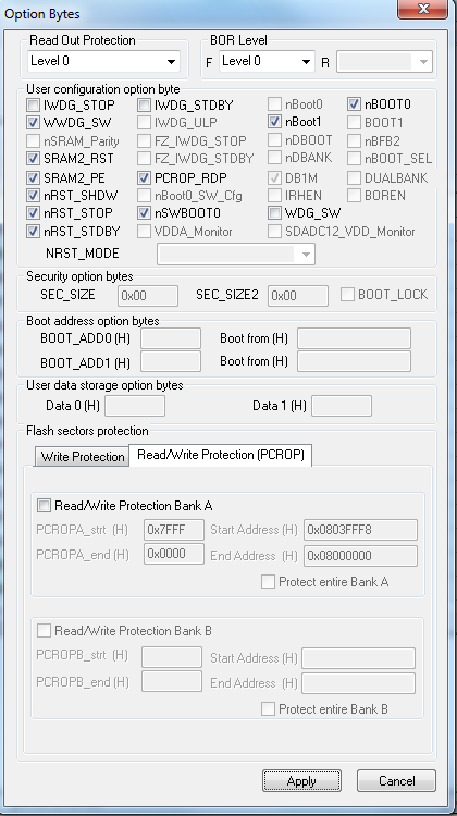

Some more info:
Bootloader: 3.1
Processor ID: 4.35 (53d)
options:
Solved! Go to Solution.

‎2020-11-18 2:26 PM
You should read two ACKs for write unprotect per AN3155.
The logic otherwise seems okay. Possibly you're missing something else on the line. I would put a logic analyzer on the line so you can see exactly what is sent at what time.
The write unprotect should not be necessary, so it's likely something is wrong.
Erasing flash can take more power as well. Ensure the chip is well powered and isn't causing a BOR.

‎2020-11-19 9:03 AM
Thanks for pointing out the two ACK. I completely missed that!
It seems the mass erase is working now, but I still can't read/write the flash, all address requests e.g. 0x80000000 are denied with NAK.
e.g.
Send: 0x31 0xCE (write )
Recv: 0x79 (ACK)
Send: 0x80 0x00 0x00 0x00 0x00 0x80 (address 0x80000000 + checksum)
Recv: 0x1F (NACK)
... etc... (everthing else is NACK'd)
If I do a "write unprotect" command before the write the proc. resets as stated before. I have looked at the signals on a logic analyzer everything looks correct...
