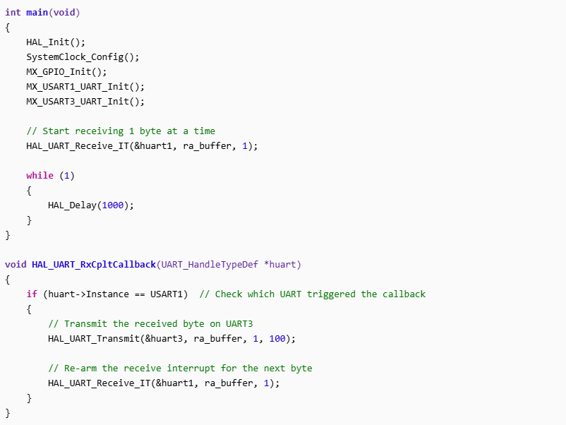

Your initial call is:
This means the HAL driver waits to receive 12 bytes before triggering the HAL_UART_RxCpltCallback. So the callback will not be called after the first byte, but only after 12 bytes are received.
In the Callback:
Here you re-arm the receive interrupt to receive only 1 byte at a time. This is why after the first 12 bytes, the callback is triggered, and then subsequent single bytes trigger the callback immediately.
If you want to receive one byte at a time and have the callback called immediately after each byte, you should:
  • Start the receive interrupt with length = 1 from the beginning.
  • In the callback, re-arm the receive interrupt again for 1 byte.
Best Regards,
Aime
