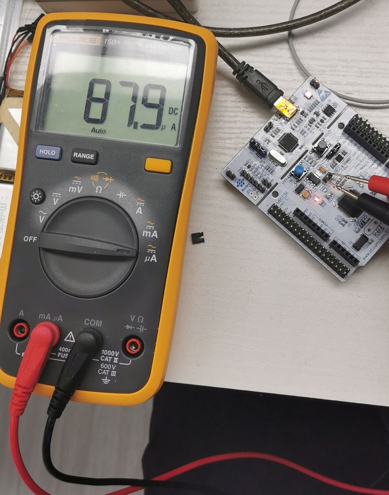

I run the example on Nucleo STM32L452 board, it works perfectly, the current consumption I got is about 6 µA. I run also the shutdown mode example and I got about 46 nA of current consumption.
Maybe you have made some changes on the board you are using and that's why you have the over current consumption ?

7 watting for the "LD2" not blinked , the current measured in "jp6" is about 87uA.

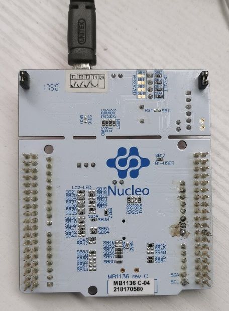

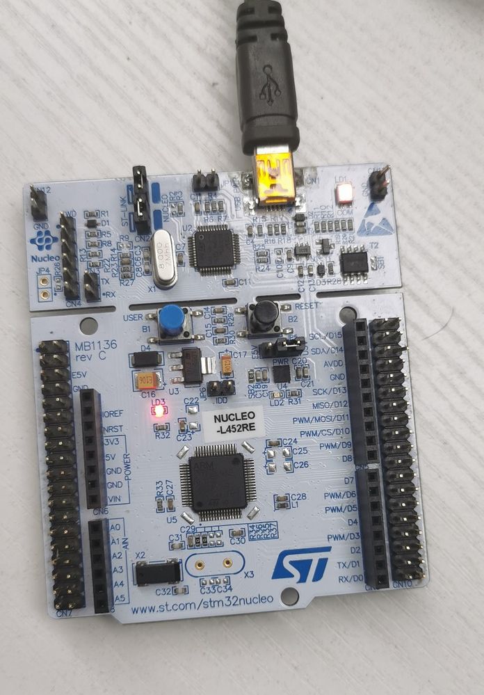

this is the photograph of my board setting,nucleo-L452RE
​0693W00000BayVAQAZ.jpg0693W00000BayVFQAZ.jpg​

After downloading the code try to unplug and plug the board again and see the current consumption.
