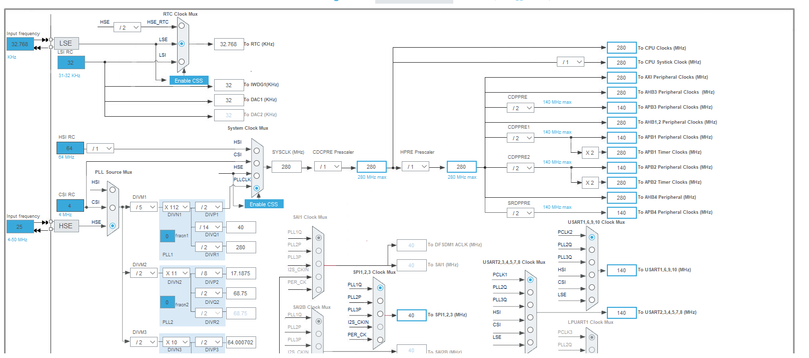

I'm working on an app utilizing STM32H7A3 with CMSIS-OS2.
I'm facing a problem with osDelay(). Most of the time it returns too early than the actual delay. While HAL_Delay() always works fine.
I have debugged osDelay(3500) with oscilloscope. It's giving a delay of 141ms.
The before and after ticks were also 5537 and 5678 respectively.
Freertos tick rate is 1000Hz.
I have also tried setting the delay between 500 and 3500. But the actual one comes out to be 100-200ms.
Any help is appreciated.

‎2024-02-13 10:52 AM
What is your MCU core clock source and rate? Have you used CubeMX/IDE to generate clock setup code?
‎2024-02-13 9:19 PM
Yes I used CubeIDE. Below is the clock configuration.
‎2024-02-13 9:23 PM - edited ‎2024-02-13 9:24 PM
@Pavel A. I think the issue is with the Freertos/CMSIS_OS2 as osThreadSuspend/osThreadResume is conflicting with osDelay.
