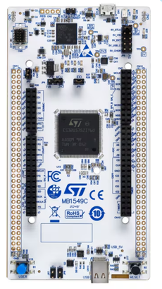

We are working to interface the  NUCLEO-U5A5ZJ-Q and nRF7002-DK using QSPI. We are using vanillas zephyr. We are able to built the code for SPI. But can not be able to built for QSPI. It will be very helpful if you provide a proper support to interface this.

I received the nRF7002-EK board. I make the all necessary connection between NucleoU5A5ZJ-Q and nRF7002-EK.
I test the shell code working on SPI interface and that get worked.
So now, I am able to operate the nRF7002 using STM32 board using SPI protocol. I am able to scan the available wifi and also get connected to one of it. This is working fine.
So now coming to a same page, My hardware setup is tested and working fine for SPI interface.
Now, I just need to figure out how to port the shell example code to work on QSPI.

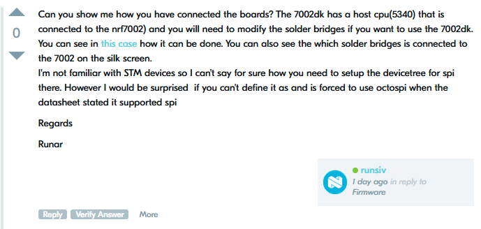

I have already ask with Nordic team. But they are taking time to reply back. And also not helping me to solve the problem. I don't know if they support the other host MCU to get work with nRF7002 via QSPI ?image.png
Yes, I require to work on QSPI instead of SPI protocol. As QSPI is more faster compared to SPI. Our application requires speed.
Please post a link to that Nordic thread.
EDIT: I guess it's this ?
