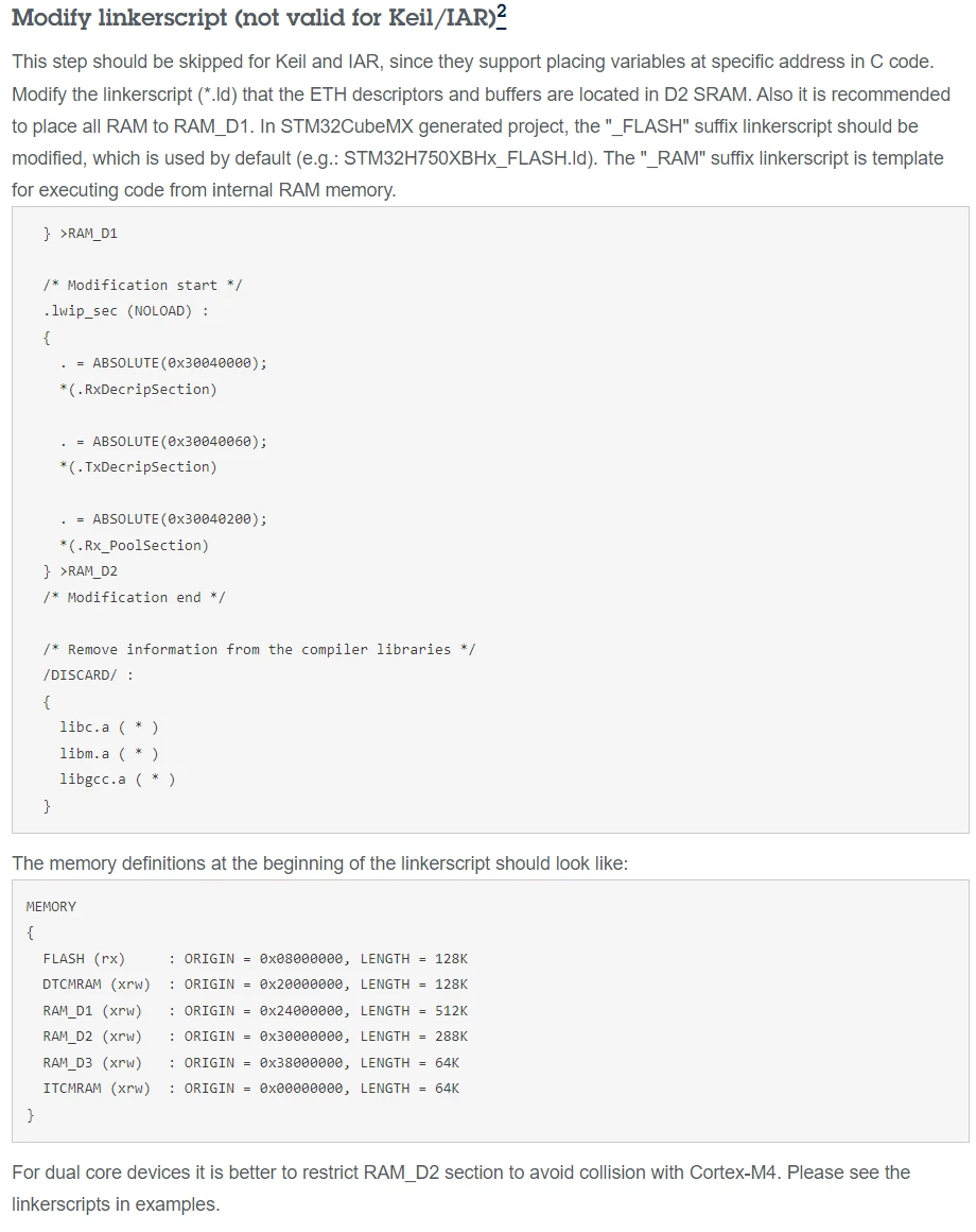

I got it working: I almost can't believe the rooot cause, and verified it:
This
  .lwip_sec (NOLOAD) : {
    . = ABSOLUTE(0x30040000);
    *(.RxDecripSection)
    . = ABSOLUTE(0x30040060);
    *(.TxDecripSection)
    . = ABSOLUTE(0x30040200);
    *(.RxArraySection)
  } >RAM_D2
Should not go into
STM32H755ZITX_RAM.ld
but into
STM32H755ZITX_FLASH.ld
So that's why it took me almost forever to get it working!

Hello @Jack3 ,
thank you for sharing with us your journey. happy that you figured it out as well.
the fact that this should be placed in the Flash.ld file is mentioned in this article How to create project for STM32H7 with Ethernet an... - STMicroelectronics Community which can help you to achieve your goal of developing TCP and UDP server and client.
here is the section mentioning this
