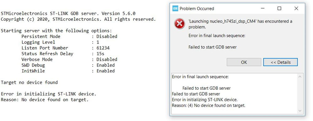

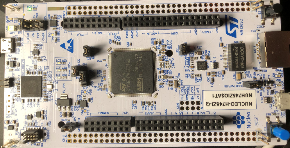

after programming the code via the OnBoard ST-Link and connecting/disconencting USB on the Device side in order to find out if the works, I can no longer access the microcontroller.
I have no idea what the rootcause is, 3.3V is fine. Could it be that the MCU is stuck in a lowpower mode(I did not configure any).
Thanks a lot.

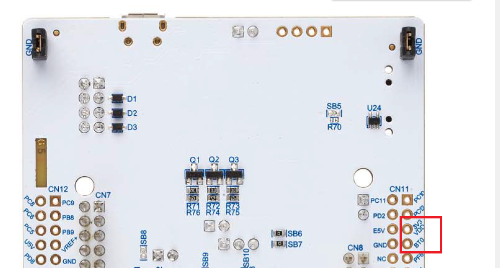

BOOT0 is a pin controlling boot behaviour into ROM or your code into FLASH.
Should be marked on one of the pin headers, and findable via the User Manual / Schematic, usually close to a VDD pin for easy connection
Ok, I found it:
  1. Disconnected the USB ( Debugger)
  2. Jumperwire from 3.3V to BT0
  3. Connected the USB (Debugger)
  4. Started the Debugging in the STMCubeIDE

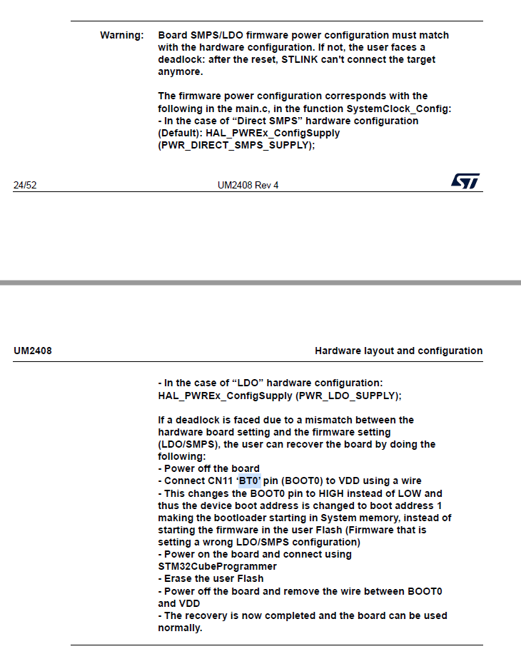

There is a seperate section in the Manual, I added it so others that read this post can find it instantly:
However, how can that be avoided? What do I have to do to not have this issue again?

Board provides for multiple powering methods, SW and HW need to be consistent.
Looking at this blindly, I'd guess you selected the LDO, not the SMPS setting
 HAL_PWREx_ConfigSupply(PWR_LDO_SUPPLY); // USED THIS, FROM H743
 HAL_PWREx_ConfigSupply(PWR_DIRECT_SMPS_SUPPLY); // WANTED THIS

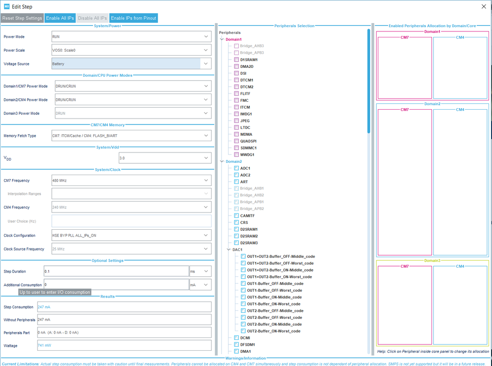

Wow, I can't even find these settings. the settings should be in the config-Tool?
All I found was this:
I'm not a CubeMX/IDE/WTF adherent, I work code the old fashion way..
