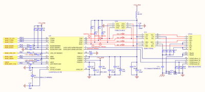

I am using a Nucelo-429zi board for development and my custom PCB schematic is based on this board.  I am experiencing a problem where about 10% - 20% of the time after a hardware reset the PHY will fail auto-negotiation.  The green led does not come on and the amber led blinks.  This happens even when on the debugger and the MCU is not allowed to run.  I only have one Nucleo board so I cannot try another to see if the problem is unique to this board.
Is this a known problem? seen before?
What could it be?  Possibly the clock circuit?

sergey23
If you can post the ethernet part of the schematic, and your ethernet firmware code snippet, that would help.
You could try to load Mongoose-based test firmware and see if the same happens. Visit https://mongoose.ws/wizard/#/output?board=f429&ide=CubeIDE&rtos=baremetal&file=README.md , select destination directory in the settings tab, click "generate" button on top right, load the project in Cube IDE, start serial console, and build & flash the firmware. Board's IP address should appear in the log, as well as the other debug info like PHY parameters, link speed, etc.
I am using the nucleo-429zi development board.  I don't think firmware is involved.  This happens before the firmware even runs.  The phy chip either fails or succeeds at auto-negotiation even if the MCU is completely erased or is prevented from running by the debugger.  Once the phy chip has failed to auto-negotiate it does not recover.  I can repeatedly perform a hardware reset on the phy chip until the auto-negotiation succeeds.  But this seems like a hack rather than a solution and how do I know that board to board variations will not produce some units which never work?
This is the schematic for the nucleo board (also see attached)..
paulrbryson
I am not sure of the cause for the original problem - i.e. a hardware reset leaves the PHY in "bad" state.  I suspect it may have something to do with the internal 25MHz oscillator not stabilizing before auto-negotiation starts?
In any event I found what looks to be a reliable solution - retstart the auto-negotiation in firmware after the PHY chip has stabilized.  I Inserted the following code in the stm32cubemx generated source, in "ethernet.c".
