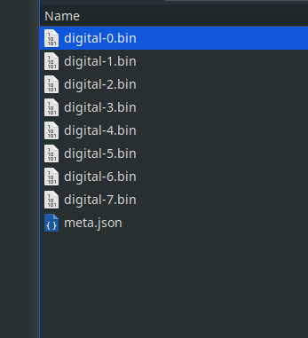

I captured the output waveform from both the TAS2110EVM (with XMOS MCU) and the STM32 setup, and I noticed that the waveforms are different. Could you please review the attached waveforms and help identify the possible cause of this issue?
PFA the waveform captures from both MCUs.
Thanks,
Jinal
What is this ?
Show a png or jpeg - if you want, i can see it.
Hi @AScha.3 ,
I’ve shared the .sal files, which can be opened using a logic analyzer.
I’ll also share waveform snapshots for your reference.
Thanks,
Jinal

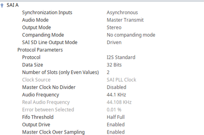

Hi @Jinal ,
so adjust the clock for SAI to 256 or 512 x Fs ; ...until "real" matches (close) the desired Fs;
see on my H743 clock tree:
+ adjust settings, as i wrote ->
a: adjust the TAS2110 to I2S standard , stereo
or
b: adjust on STM something similar to PCM for DSP, Ti format (afair).

>the ratio is set to 256 with an SCLK of 12 MHz
Thats not important, to have 256; you need to set, what the SAI needs, with your setting. (Fs, bits/frame, etc.)
As seen in my last post, i set it to 256x Fs, to get 44,1k .
And 12M is no audio clock, maybe 12.288 M , is 256 x 48k Fs.
So first decide, what you want : 48k or 44k1 .
